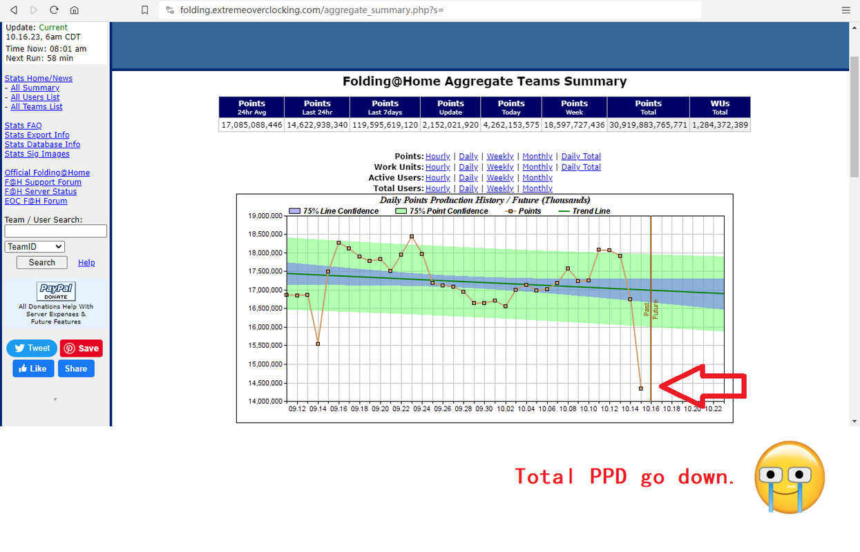

fz4z
Posts: 38
Joined: Fri Jul 16, 2021 10:22 am
Re: missing points from all projects 19600 since yesterday
Post by fz4z »
Site Admin
Posts: 8281
Joined: Tue Apr 21, 2009 4:41 pm
Hardware configuration: Mac Studio M1 Max 32 GB smp6
Mac Hack i7-7700K 48 GB smp4
Location: W. MA
Post by Joe_H »
I have access to a different graph that shows the total points and hours being logged by the stats database, that does not show such a dip. I suspect there is also a problem with generating the flat files that EOC downloads to use for its stats display.
