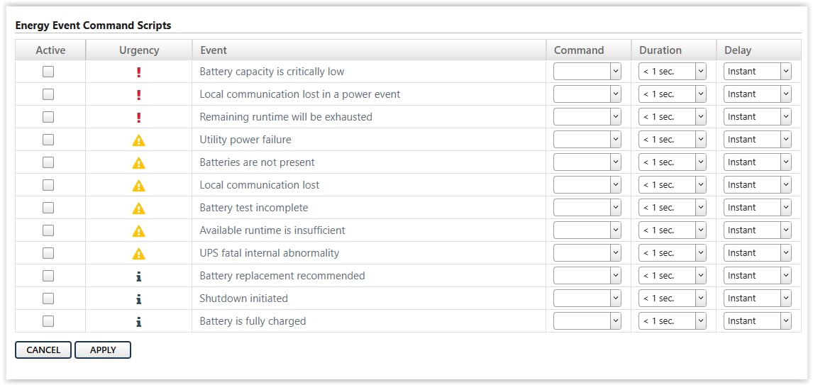

Asking sellers, one said (translated):
"Good morning, the advanced HID interface allows you to connect it to the PC via the PowerMaster Plus Local software.
In the (Advanced->Setting) section, you can create scripts that the software will launch when the condition occurs. The scripts must be saved in the extcmd folder where Power Master + Local is installed. Once the script is created, it will be displayed in the Command combo box.
The script can be associated with a specific event (shown in the attached image) out of the 12 supported ones."
Attaching this image:

Also, my concern remains how to know if it works with Folding and BOINC. Some say not all HIDs will work with Folding, some say it should be okay. If I'm wrong I'll need to send it back, covering the expenses (it'll be my fault).
Some vendor said that the UPS has a battery icon on Windows, which will be substituted if I install the software. Does that mean it works as I need? Is it sufficient or should I check more?

Tropical Snowman wrote: Thu Nov 27, 2025 1:01 pm Some vendor said that the UPS has a battery icon on Windows, which will be substituted if I install the software. Does that mean it works as I need? Is it sufficient or should I check more?
That should be sufficient. First try and see if the battery status shows up in the client by testing to see if it pauses if you disconnect the AC. Try it another time if you do install and run their software. It may or may not intercept the battery status detected by the OS and keep it from being passed on directly to the folding client.
