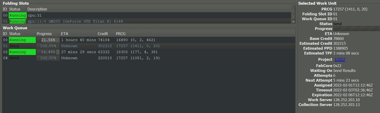

I have another WU for the GPU mapping to another server now, let's see if that one also gets stalled and not accepted when completing...
I'll keep you updated later on as the WU still needs about 1h to complete.
Right now it looks like this:
Note how only the two WUs from PRCG_17257 appear to be stalled while no other WU is in this state.

Okay, after fiddling around with the settings I found Kaspersky Internet Security to be extremely invasive when it comes to data traffic.
For all those who also have stuck WUs and get the zero-byte response here's where you have to tell Kaspersky not to mess around with your data:
1. Like toTow already mentioned, check that you add FAHClient to your Program Exclusions. (will write in german here as I don't have the english KIS)
- Open your KIS and click the gear icon at the lower left
- Click on "Netzwerkeinstellungen" on the left, then on the main screen seek for "Vertrauenswürdige Programme" and click it.
- Add FAHClient.exe and FAHControl.exe to this list and check every item in the following screen. (2 rules)
- Note the arrow to the right at the "Verschlüsselten Datenverkehr nicht untersuchen" and click it to change this entry to "Gesamten Datenverkehr nicht untersuchen"
