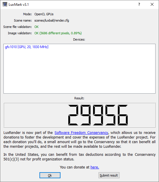

I have no idea how either issues are caused or what to do to resolve them, but I did remove the GPU slot and I am now exclusively folding on my CPU. CPU folding worked from the start though, even with the GPU slot.
EDIT: I performed an OpenCL benchmark with my 5700 XT using LuxMark and it runs just fine. OpenCL itself does not appear to be bugged.
Re: Radeon 5700 XT unsupported due to driver issues [19.9.1]
!) I wonder if AMD is now distributing a different Windows driver than it was earlier.Roos-Skywalker wrote:I have no idea how either issues are caused or what to do to resolve them, but I did remove the GPU slot and I am now exclusively folding on my CPU. CPU folding worked from the start though, even with the GPU slot.
2) Has this problem been observed on both Linux and Windows?
3) I wonder if your OpenCL benchmark exercises all of the functions needed by FAHCore_2*? (such as Mixed Precision)
4) Did you install OpenCL 1.1 or >=1.2? (Show us FAH's log)
I certainly hope the AMD problem has been fixed but I'm a little reluctant to accept your benchmark as representative of the requirements of the FAHCores. Have you tested it with FAHBench?

Passing one benchmark does not prove that the OpenCL implementation in the drivers for the 5700 XT is not buggy. Reviewers testing the card when it first came out observed that some of their standard OpenCL tests worked, but many others in including FAHBench did not.Roos-Skywalker wrote:EDIT: I performed an OpenCL benchmark with my 5700 XT using LuxMark and it runs just fine. OpenCL itself does not appear to be bugged.
