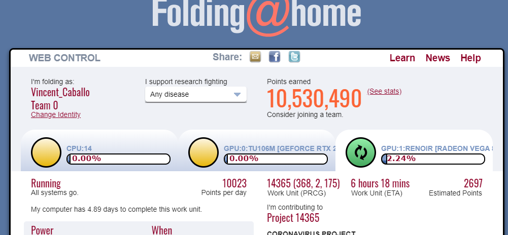

Hi,
Please add support for Renoir GPUs.
*********************** Log Started 2020-05-27T19:54:38Z ***********************
19:54:38:Trying to access database...
19:54:38:Successfully acquired database lock
19:54:38:Read GPUs.txt
19:54:38:Enabled folding slot 00: READY cpu:14
19:54:39:ERROR:FS02:OpenCL GPU not found for 'opencl-index' = 1 with vendor ID = 0x10de, please correct this by removing the manually configured 'opencl-index' option.
19:54:39:ERROR:FS02:CUDA device not found for 'cuda-index' = 1, please correct this by removing the manually configured 'cuda-index' option.
19:54:39:Enabled folding slot 02: READY gpu:0:TU106M [GeForce RTX 2060 Mobile / Max-Q] 4550
19:54:39:Enabled folding slot 03: READY gpu:1:Renoir []

19:54:39: GPU 0: Bus:1 Slot:0 Func:0 NVIDIA:7 TU106M [GeForce RTX 2060 Mobile /
19:54:39: Max-Q] 4550
19:54:39: GPU 1: Bus:4 Slot:0 Func:0 UNKNOWN_ENUM:0 Renoir []
19:54:39: CUDA Device 0: Platform:0 Device:0 Bus:1 Slot:0 Compute:7.5 Driver:11.0
19:54:39:OpenCL Device 0: Platform:0 Device:0 Bus:1 Slot:0 Compute:1.2 Driver:445.87
19:54:39:OpenCL Device 1: Platform:1 Device:0 Bus:4 Slot:0 Compute:1.2 Driver:3004.4

19:54:39: <!-- Folding Slots -->
19:54:39: <slot id='0' type='CPU'/>
19:54:39: <slot id='2' type='GPU'>
19:54:39: <cuda-index v='1'/>
19:54:39: <gpu-index v='0'/>
19:54:39: <opencl-index v='1'/>
19:54:39: </slot>
19:54:39: <slot id='3' type='GPU'>
19:54:39: <gpu-index v='1'/>
19:54:39: <opencl-index v='0'/>
19:54:39: </slot>
19:54:39:</config>

Re: Renoir GPU (AMD Ryzen 4900HS) Support
Posted: Wed May 27, 2020 10:26 pm
by JimboPalmer
What happens is that the first volunteer with a new GPU (that would be you) tells us the Device ID. I use GPU-Z to see the Device ID.
https://www.techpowerup.com/gpuz/
Then someone enters this in a server and the server generates a new GPUs.txt file which should automatically download. (If it does not, once they tell you it is updated on the server, just delete your copy and it will download)
19:54:39: </slot>
19:54:39: </slot>
I also think you or the software have mixed up the GPUs. I think gpu-index 0 should be opencl-index 0 and gpu-index 1 should be opencl- index 1
Nvidia's driver should be 445.87, and AMD's should be3004.4.

Yep, I actually made the changes manually to the GPU.txt config adding Renoir after doing fahclient --lspci and getting the information there. My bad for the FAHClient config, I messed up that one but I corrected it now.
I'm folding on the Renoir but its quite slow, maybe because its not supported yet? Or that's just how fast the integrated GPU can do?
Posted: Thu May 28, 2020 7:53 pm
by Joe_H
If something is "folding on the Renoir", you have probably ended up with a misconfiguration that has resulted in a slot that appears as a GPU slot, but is actually processing CPU WUs instead on your CPU. We have seen this before when people have added in an entry for an unsupported GPU.
Expanding out your image to see it in full, and that is exactly what is happening. Project 14365 is a CPU project, it is not using the Renoir IGP.
Set the folding on that WU to Finish, and remove the slot after it has completed and uploaded.
Once someone has a chance to add this GPU, you will need to download a new copy of GPUs.txt and restart FAHClient. Easiest would be with a reboot. Then you can set up a GPU slot for the Renoir.
Posted: Thu May 28, 2020 7:56 pm
by bruce
I've added this GPU. You get to beta test it. Let us know what you find.
Posted: Thu May 28, 2020 7:59 pm
by JimboPalmer
Your copy of GPUs.txt is not the master, until you give them the Device ID, they can't update the master on the server.
Besides the Device ID , you could give us a more recent Log to study.
Posted: Thu May 28, 2020 8:10 pm
by sendentaryvince
Joe_H wrote:If something is "folding on the Renoir", you have probably ended up with a misconfiguration that has resulted in a slot that appears as a GPU slot, but is actually processing CPU WUs instead on your CPU. We have seen this before when people have died in an entry for an unsupported GPU.
Yes, you're right. It is working out of an a7 core which I read only does avx_256
19:43:36:ERROR:FS02:OpenCL GPU not found for 'opencl-index' = 1 with vendor ID = 0x1002, please correct this by removing the manually configured 'opencl-index' option.
19:43:36:Adding folding slot 02: READY gpu:1:Renoir [Radeon Vega 8 Mobile]

Looks like its running on GPU now. It's on a 0x22 core. I just manually uploaded the gpus.txt file from:
https://apps.foldingathome.org/GPUs.txt and then restarted my client.
Thanks for your help!

According to the results you showed in GPU-Z at the top of this topic you have a device 1002 1636. The man-readable information in the master copy of GPUs.txt says it is a Renoir [Ryzen 4900HS mobile]. If you followed the instructions given above and deleted the copy of GPUs.txt that you edited, you should see that information when you restart FAH.
If your CPU can't handle the heat of running both an AVX process on your CPU and whatever GPU driver you have for device 1002 1636, maybe it's at it's at its thermal limit. GPU-Z is going to tell you the truth. Be sure you left at least one CPU-thread to supply data to your GPU.
If you are judging by the initial estimates of progress for a new project, give it time to collect enough data to project how long it will take to complete.

I think the CPU can do more than 10k PPD.
Would be interested in seeing CPU only PPD, and GPU only PPD on this one!
They're only the first of a line of IGPs that could be interesting to fold on.
Posted: Sun May 31, 2020 1:04 pm
by BobWilliams757
I'm real interested to see what kind of PPD average these things will end up with. They are taking an interesting approach going with the Vega 8 and bumping up clock speeds quite a bit over previous APU's.
With that memory I'm going to guesstimate PPD in the 86-90K range as an average.
When people start buying the newly supported 4266 Mhz ram it should be really interesting!
Posted: Sun May 31, 2020 5:51 pm
by MeeLee
Yes, Ryzen CPUs are very susceptible to RAM speeds. I would imagine that also translates to IGPs, as they also use that same RAM as shared VRAM.
